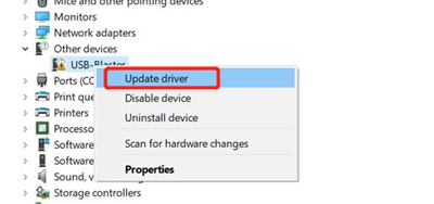

1. Right-click on the "USB Blaster" and then select "Update driver …".

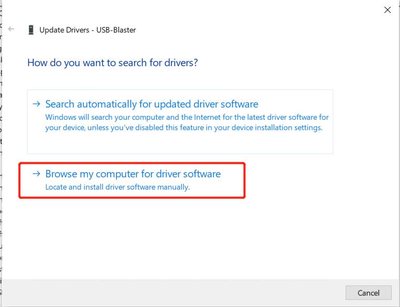

2. Select "Browse my computer for driver software"

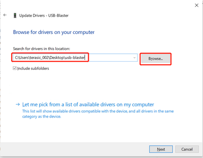

3. Select "Browse..." to select the driver we have provided to you, then click “Next” to install the driver.

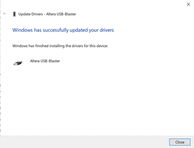

4. After that you should install the driver successfully
