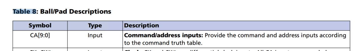

A:CA 是Command/address inputs (截图来自 C5G_v.1.2.2_SystemCD\Datasheet\LPDDR2\U80M_4Gb_mobile_lpddr2_s4_sdram.pdf):

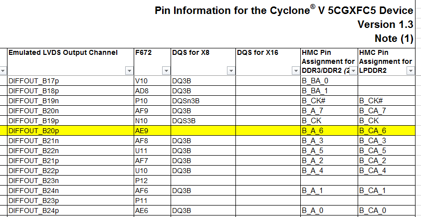

这是专用的pin, 应用上必须选择HMC (截图来自  https://www.intel.com/content/da ... clone-v/5cgxfc5.xls):
