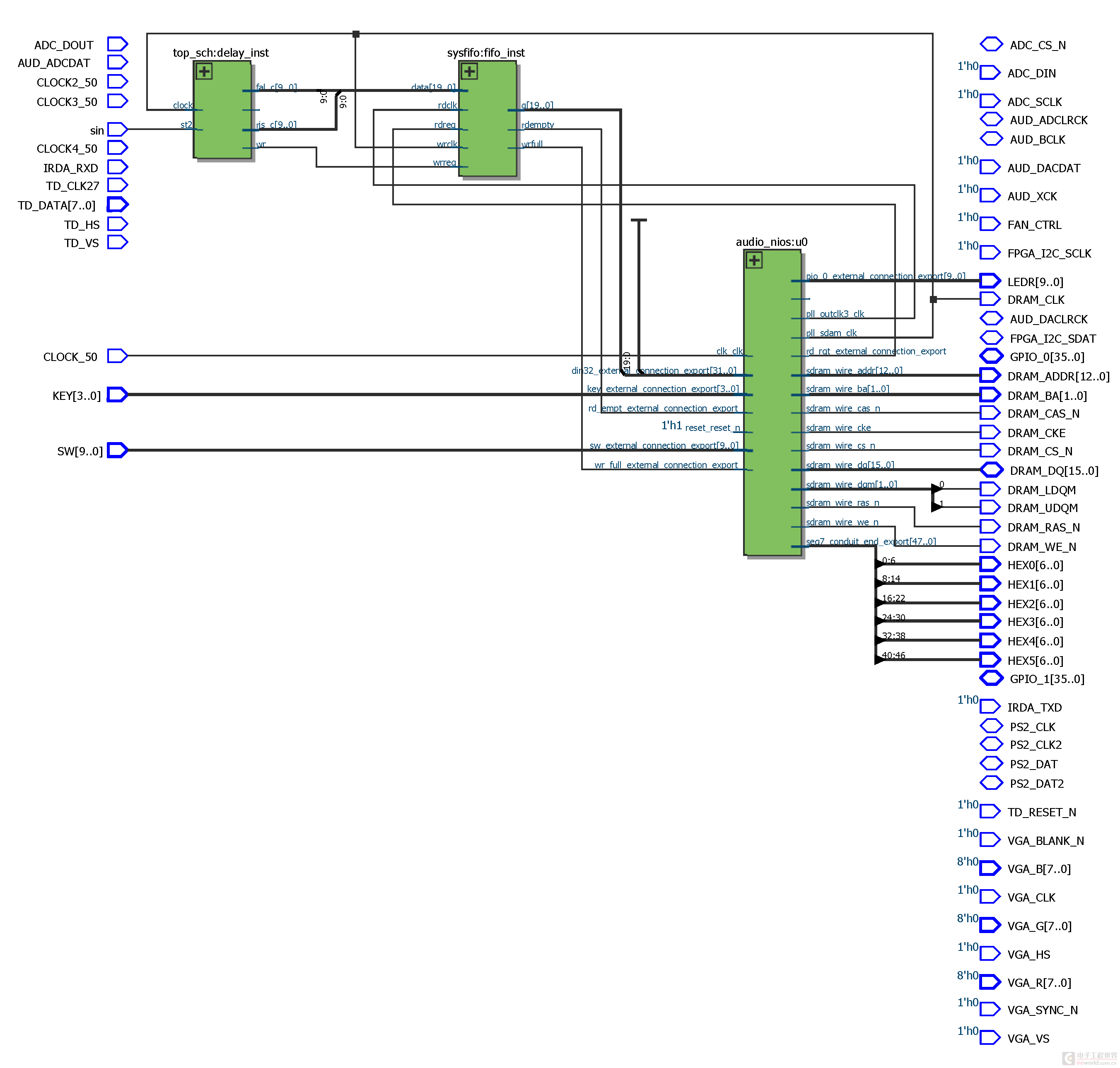

BOB_Sun 发表于 2015-8-5 09:08:27
//  Structural coding
wire reset_n;
assign reset_n = 1'b1;
//  delay_inst
top_sch delay_inst(
        .clock(DRAM_CLK),
        .st2(sin),
        .wr(wr_rqt),
        .ris_c(ris_c),
        .fal_c(fal_c)
sysfifo fifo_inst(
        .data({{12{1'b0}},ris_c,fal_c}),
        .rdclk(rd_clk),
        .rdreq(rd_rqt),
        .wrclk(DRAM_CLK),
        .wrreq(wr_rqt),
        .q(din),
        .rdempty(rd_empt),
        .wrfull(wr_full));
audio_nios u0(
                .clk_clk                                (CLOCK_50),                            //                         clk.clk
                .reset_reset_n                          (reset_n),                      //                       reset.reset_n
                .pll_sdam_clk                           (DRAM_CLK),                       //                    pll_sdam.clk
                .pll_outclk3_clk                        (rd_clk),
                .key_external_connection_export         (KEY),     //     key_external_connection.export
                .seg7_conduit_end_export                ({
                                              HEX5P, HEX5, HEX4P, HEX4,
                                              HEX3P, HEX3, HEX2P, HEX2,
                                              HEX1P, HEX1, HEX0P, HEX0}),            //            seg7_conduit_end.export
                .pio_0_external_connection_export       (LEDR),   //   pio_0_external_connection.export
                .sw_external_connection_export          (SW),      //      sw_external_connection.export
                .din32_external_connection_export   (din),   //   din32_external_connection.export
      .wr_full_external_connection_export (wr_full), // wr_full_external_connection.export
      .rd_rqt_external_connection_export  (rd_rqt),  //  rd_rqt_external_connection.export
      .rd_empt_external_connection_export (rd_empt),  // rd_empt_external_connection.export
                .sdram_wire_addr                        (DRAM_ADDR),                    //                  sdram_wire.addr
                .sdram_wire_ba                          (DRAM_BA),                      //                            .ba
                .sdram_wire_cas_n                       (DRAM_CAS_N),                   //                            .cas_n
                .sdram_wire_cke                         (DRAM_CKE),                     //                            .cke
                .sdram_wire_cs_n                        (DRAM_CS_N),                    //                            .cs_n
                .sdram_wire_dq                          (DRAM_DQ),                      //                            .dq
                .sdram_wire_dqm                         ({DRAM_UDQM,DRAM_LDQM}),                     //                            .dqm
                .sdram_wire_ras_n                       (DRAM_RAS_N),                   //                            .ras_n
                .sdram_wire_we_n                        (DRAM_WE_N)                    //                            .we_n
Endmodule
